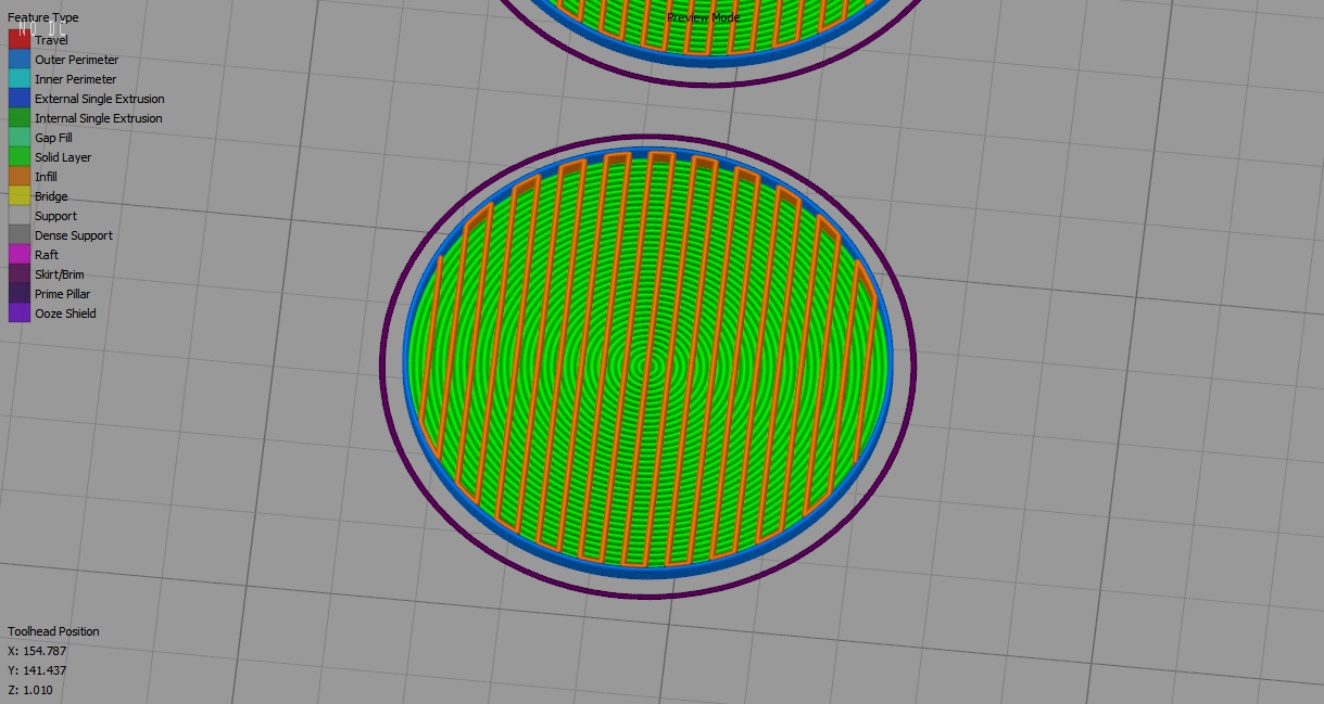

A tip for making a good-looking lens for larger headlights (for example, the headlight on Cromwell turret).
I imitate the inner structure of the headlight lens using vertical infill.
I use alligned rectilinear infill.
Its name also depends on your slicer.It may be called something else.
Basically, it's an infill that does the infill in one direction only, with straight aligned lines.
I use only one layer for the bottom of the lens.I use 4 layers for the top.These layers are concentric, not rectilinear.
Only one perimeter, for a good looking result.
Top solid layers: 4
Bottom solid layers: 1
Perimetes: 1
Fill pattern: Alligned rectilinear
Internal fill angle: 90°
Fill density: 20-25%
Top fill pattern: Concentric
Bottom fill pattern: Concentric
This is how it looks from the inside:

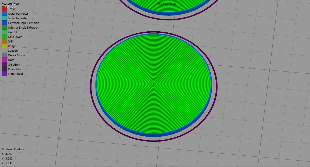

And from the outside:
