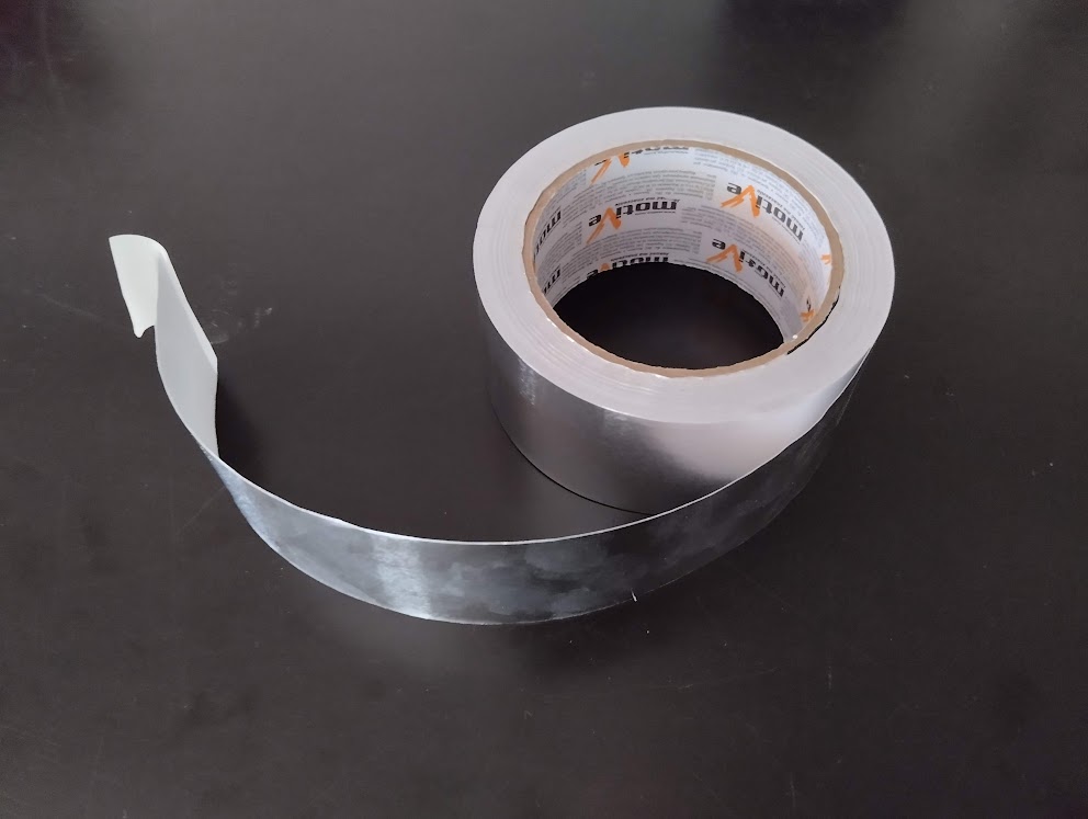

You will need:
1. Aluminium tape
https://www.amazon.com/Aluminum-Foil-Ta ... +Foil+Tape

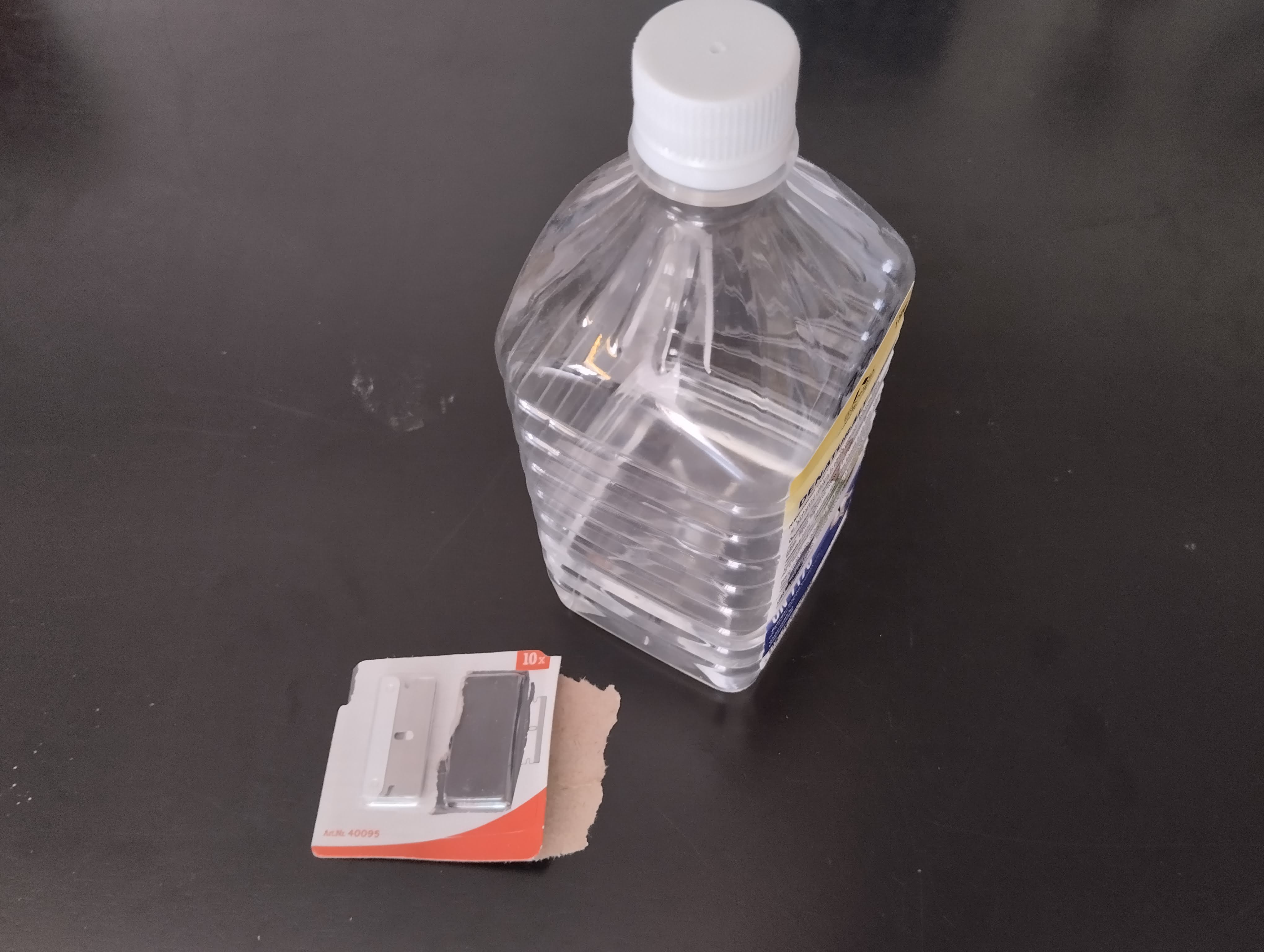

2. A sheet of translucent plastic.
Thicker is better.
You can use any flat plastic wrap.
For example, even a plastic bottle if it is squared.

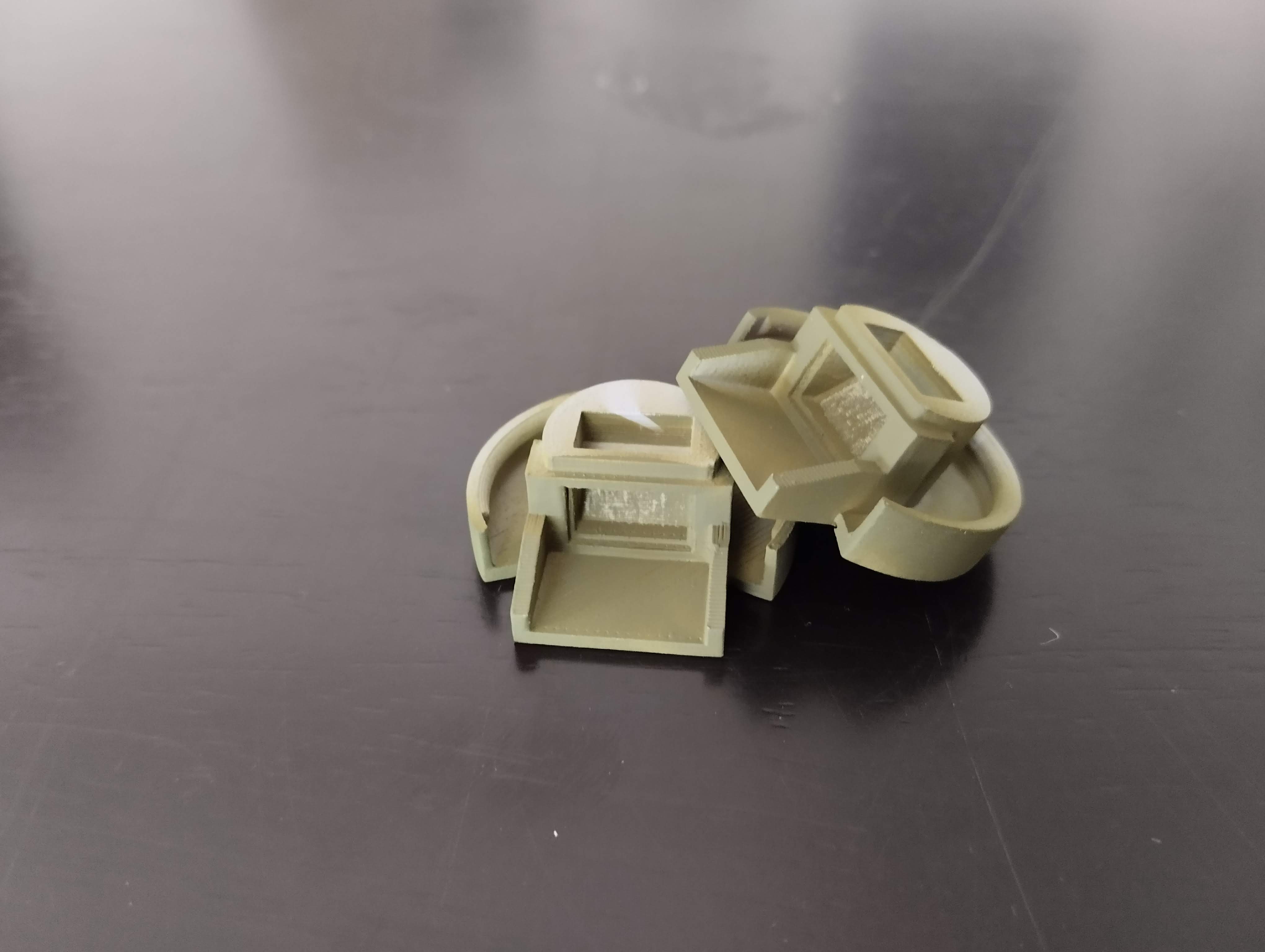

3. Periscopes
Instructions:

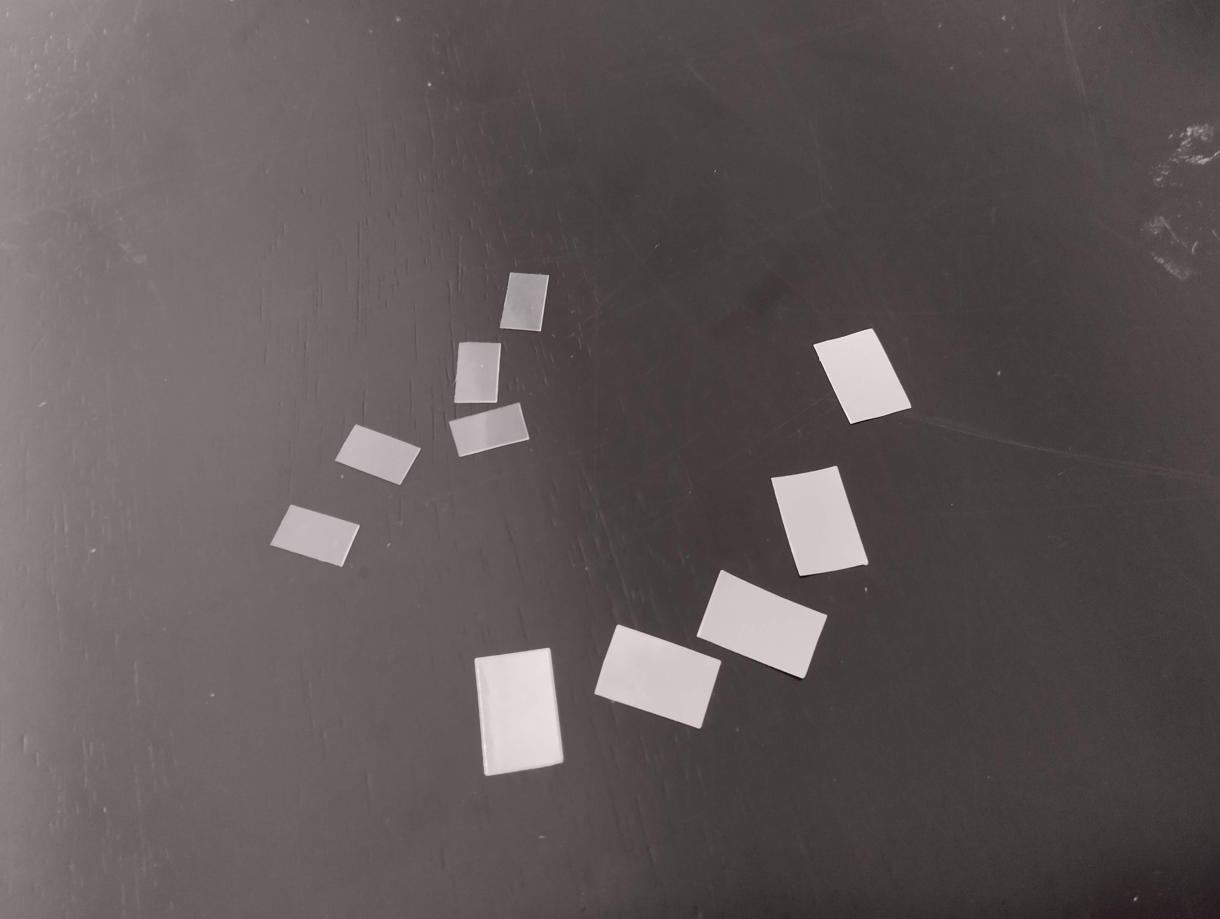

1. Prepare precisely cut squares of both aluminium foil and translucent plastic.
This is the hardest part.

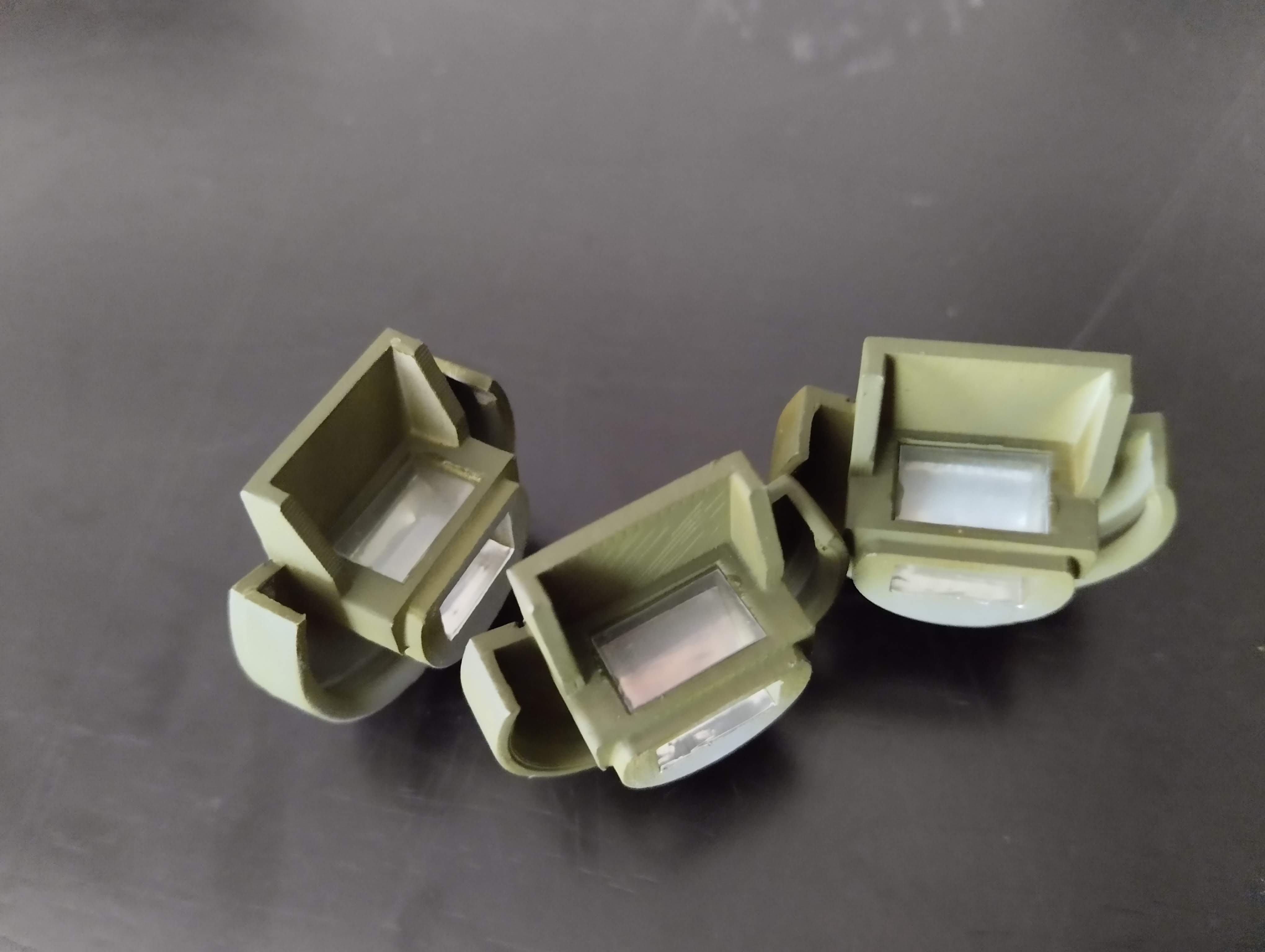

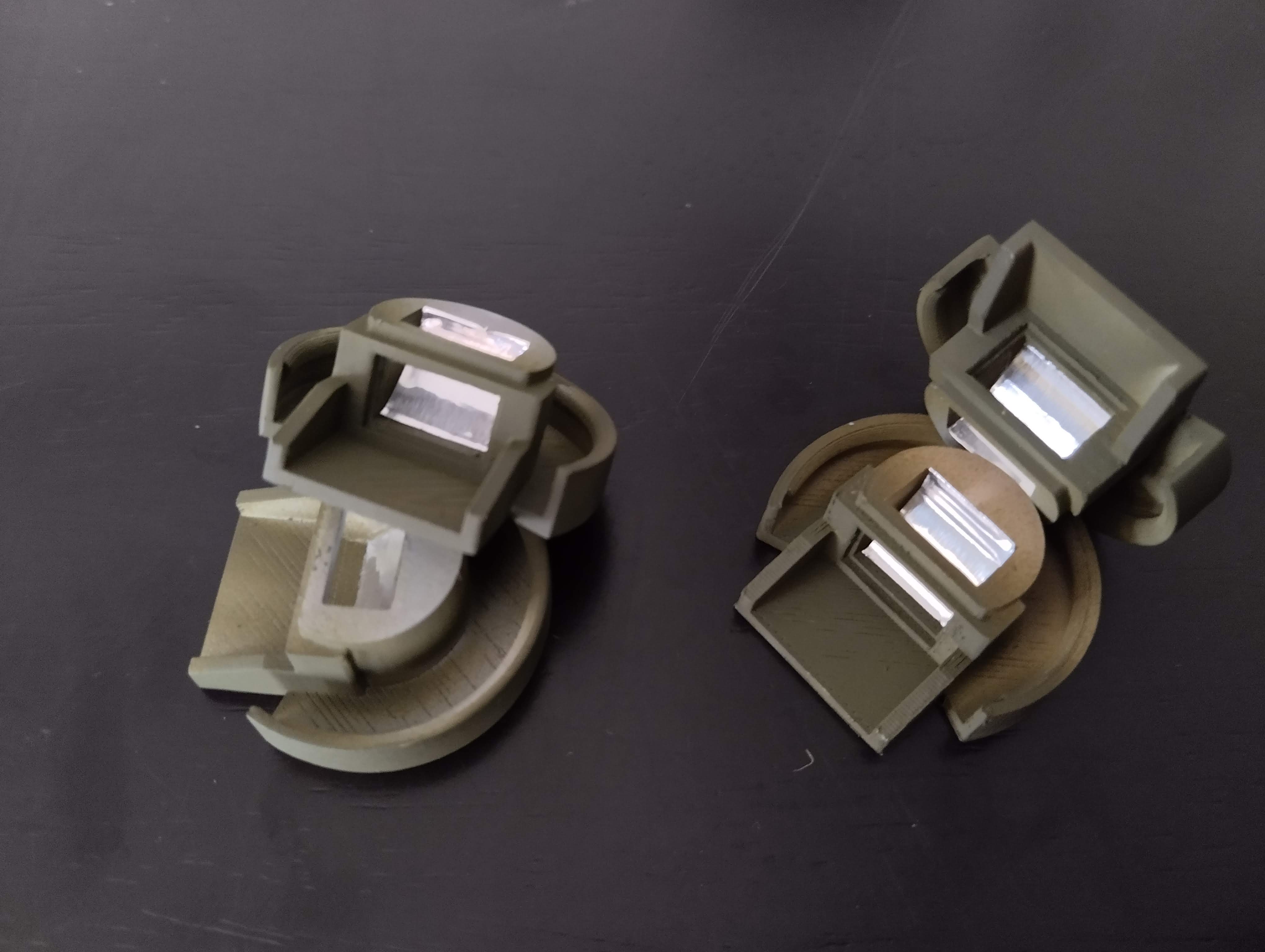

2. Stick the aluminium foil inside.
It's easy.The tape is self-adhesive.
Use something soft, like ear cleaning sticks, to press the tape down.

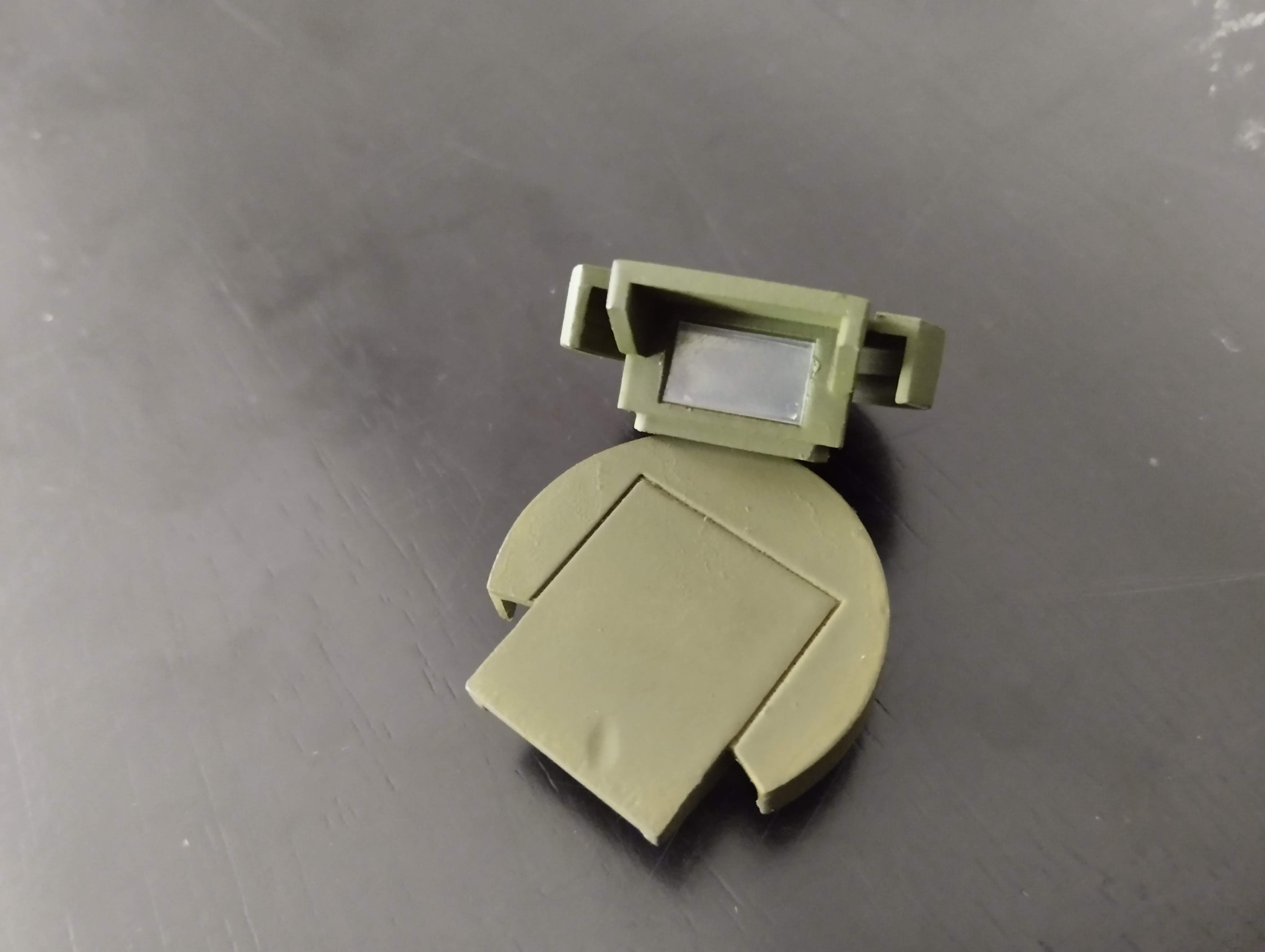

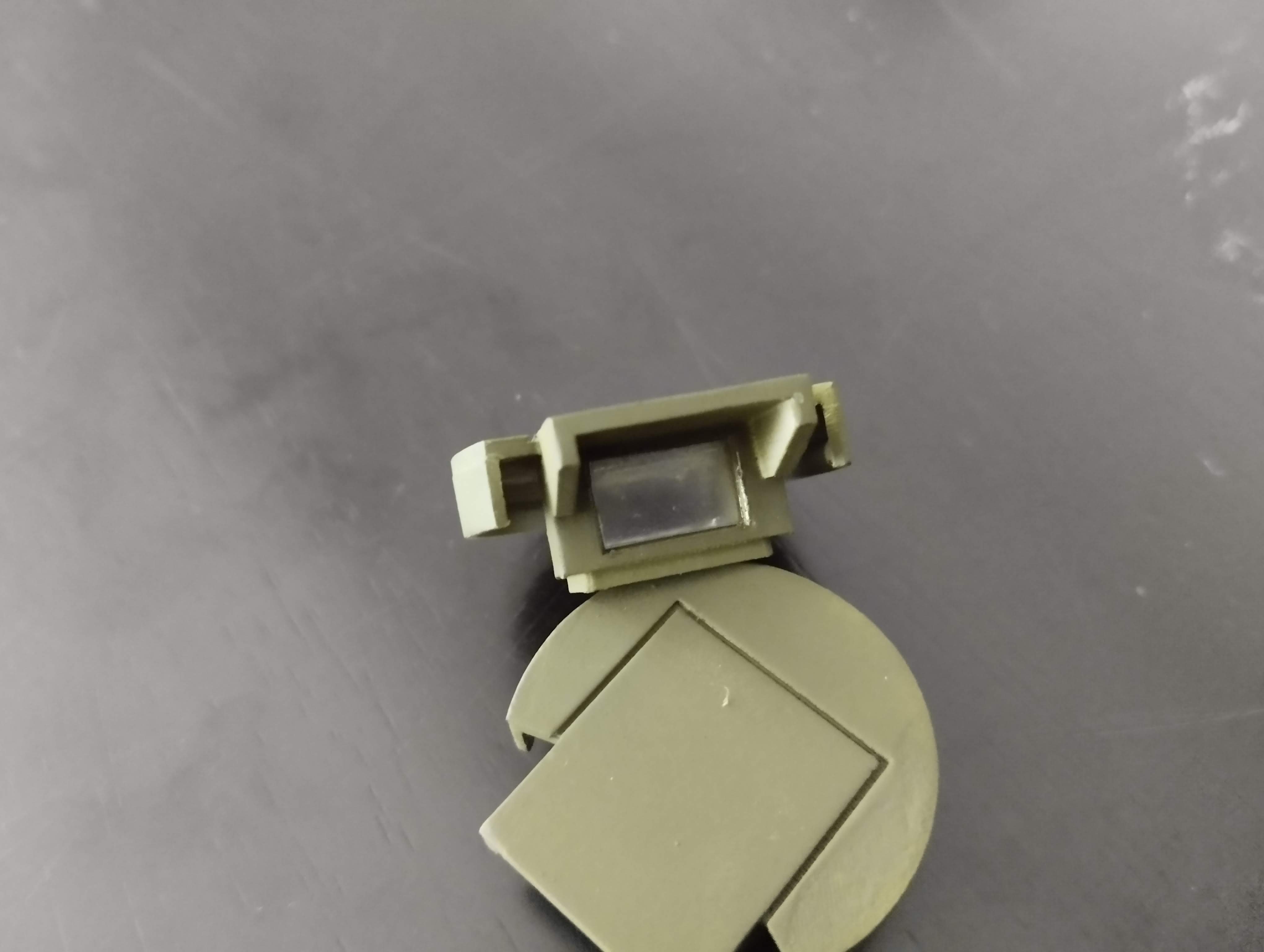

3. Glue translucent plastic - an imitation of periscope glass.
If you are using a second glue, use only a very small drop.
Almost any glue will be visible if it leaks where it is not supposed to be.
Done.
