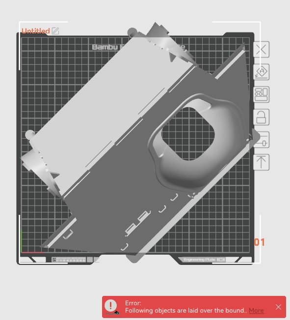

Can the 1/6 Hetzer be printed on a Bambu Lab H2S without scaling it down? The model requires a 350 × 350 × 350 mm build volume, while the H2S has a 340 × 320 × 340 mm build volume. Would the Hetzer still fit, or would some parts need to be split?

i took a look at it and unfortunately, it won't fit.
To print on H2S, you would need to split at least three large parts.
